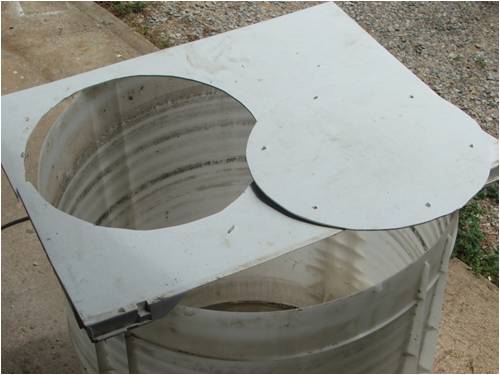

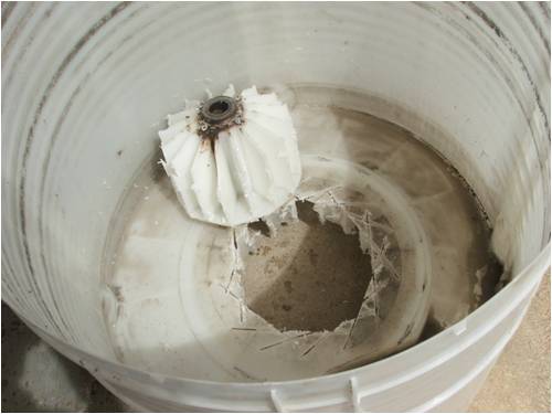

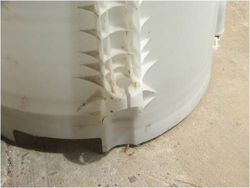

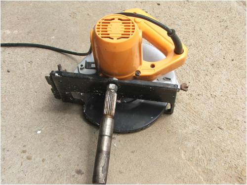

The bearing holder at the bottom of the tub is well worth keeping when 'reverse engineering' an F&P washing machine for all of the good bits, but it can be awkward to get out.
A method which works for me is to use a small circular saw. but this can be dangerous and awkward to use in the confines of the tub, so I have fitted it with half of an old F&P shaft which slides into the existing bearings and keeps it centred. A couple of suitable nuts lock it into a hole drilled into the plate of the saw to give the required radius cut. I kept mine fairly wide as I required a large flange to screw it to the baseboard of the handcranked generator I was building – it can be cut down further later if required. It requires a dozen or so plunge cuts from each side and then what remains of the plastic webs can easily be cut through with a hand saw or an electric sabre saw.

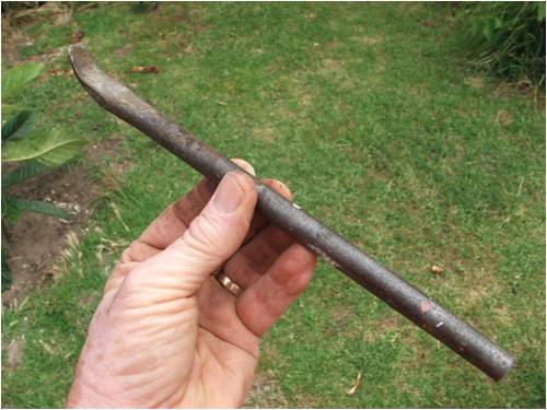

This is the tool I use to drive the bearings out of the housing. The curved end can be used to drive against the outer race of the bearings in several places without damaging them. It also works on the seal.

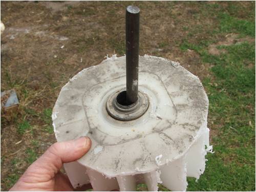

If you have access to a metal lathe here's another way to remove the hub.
I use a 75mm hole saw, I have a length of broom handle that fits snugly into the bearings the broom handle has been put in a metal lathe & a centre hole drilled to accomodate the arbour for the hole saw.
I drill from both sides of the hub & only have a small bit to cut out with a key hole saw where the hole saw isnt deep enough.

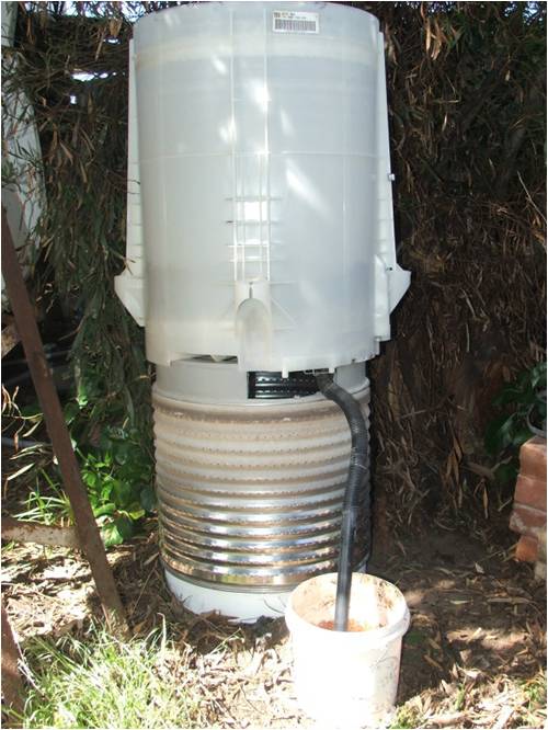

The Wednesday before Christmas turned out to be a rather good day.
I came in from an enjoyable late afternoon surf and my wife, who had been reading in the car, said "Did you see that washing machine on the footpath back there - is it a F&P?". As soon as I had changed I walked back to check it out and, sure enough, it was a nice little F&P 501. A quick check with the owners of the house that it was OK to take and I was off home for the trailer.
It turned out that it was in quite good condition - probably could have fixed it but another washing machine wasn't really needed so I set about reverse engineering it.
I must say I am always impressed by Kiwi ingenuity every time I pull one of these machines apart.
After removing the motor and all of the other 'good bits' I thought "Why not make a worm farm out of the leftovers"
What follows is a description of how I went about it - hopefully Gizmo does not mind the forum going off topic just a little in the interests of recycling!

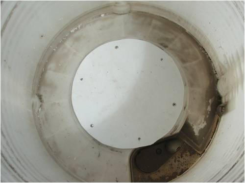

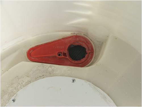

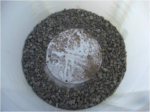

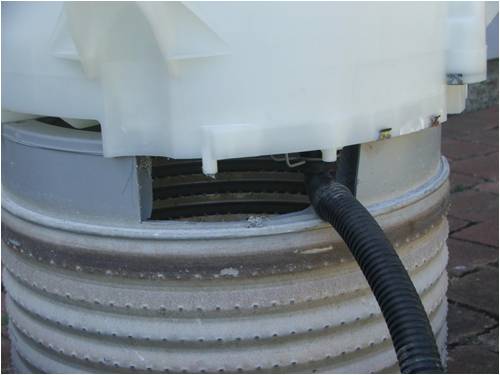

First I removed the pump (ingenious bayonet fixing) and its internal plates and sealed its drain hole in the tub by siliconing in a disk of plastic cut from the lid. The hole in the middle of the tub where the bearing was cut out was also sealed in a similar way.

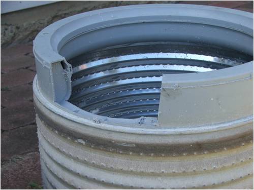

Then I made a stand from the inner perforated tub by cutting a section from its rim to clear the pump housing and to enable the drain hose to be re-fitted - I used a jig-saw for this but watch out for the water which comes out!
A couple of the plastic mounting spigots on the bottom of the white tub needed to be lopped off to enable it to sit neatly on its stand.

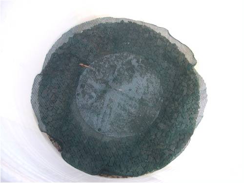

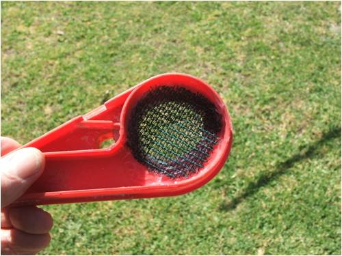

The intake hole in the internal pump plate was enlarged and then a strainer of plastic shade cloth was glued into it with silicon and it was re-fitted. This was loosely covered with a plastic baffle plate also cut from the lid.
The drain channel around the circumference of the plastic tub was filled with gravel and then the whole base of the tub covered with a large circle of shadecloth to keep the wormcastings, worms and food out of the gravel and drain below.

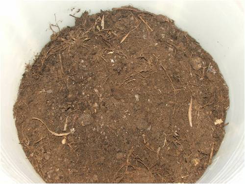

The whole contraption was then set up in a cool, shaded spot under a tree in the back yard and a large bucket full of good compost mixed with shredded paper was spread out on top of the shade cloth. The drain pipe was cut to a suitable length and put into a smaller bucket ready to catch the worm juice - now for the workers!!
Composting worms were sourced from a local supplier but can also be obtained by mail order or from garden centres and some hardware stores. Ordinary garden worms are not really good enough - they need to be a mix of Tiger worms and Red worms which are surface feeders.
Before adding them, the bedding material was watered well and allowed to drain - it needs to be moist but not soggy or the worms will drown.
A well moistened square of old carpet was placed on the compost and worms to give them somewhere to hide and a lid held down with a brick on top to keep the rain out completed the job.
Lots more info on farming worms can be found on the net.

going to get heavy isnt it?
perhaps a couple of stakes through the shock absorber mounting points to help it not fall over.
I like it but thinking its overkill, the stainless part alone makes a great composter
Posted: 09:15am 26 Dec 2009
Think its more of a matter if you are using worms to compost and reap all the benefits from the goodies produced including the worm juice.
This way he turns the compost into a greatly enriched organic matter, a living thing.
Compared to some decomposting pile, with a much lower end product.
Worms take a bit of looking after and to maintain the conditions they perform best at, also need to be considered, as Trev has.
A couple of stakes either side as mentioned would make me a little less nervis as well.
Good job!

In reply to Karl's comments-
It looks more unstable in the photo than in reality because of the low angle it was taken at. It really sits solidly on the ground and should not become unstable even when half full. With worm farming, the idea is to regularly remove the worm castings to use as a soil conditioner/fertilizer. This is done by putting the food all to one side for a few days - the worms move across to this and the casts can be removed for use relatively worm free. I considered cutting the drum off to about 3/4 height and may do so in the future - easily done with the jig saw.
As for the stainless part - I don't think it is real stainless - just plated steel and it's a bit useless for a composter because it's too small and would be awkward to turn the compost in, especially with the bulky plastic rim. My aim was to use as much of the original washer as possible with the minimum effort to build - it cost me practically nothing, compared to commercial worm farms which can be as much as A$250+ for a converted wheelie-bin type.
A more elaborate stand could have been made of bricks or timber but the stainless drum made it quick and easy. It is better to raise it up so that the worm juice can be drained out easily to use as a very effective fertilizer.
Worm farms have another benefit in that no methane is produced as there is when food waste is buried in landfill. Many local councils are encouraging homeowners to have their own worm farms to cut down on the amount of organic matter going in to landfill.
