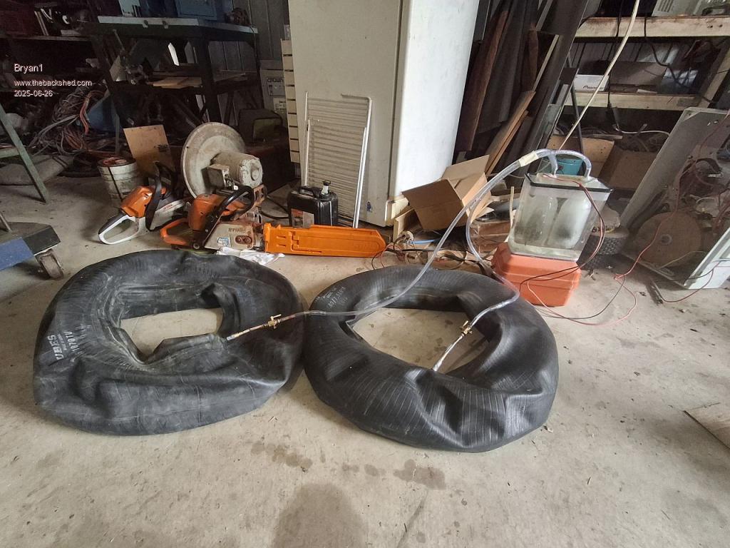

Well ran the unit again this morning and found there was a leak on the negative side under the wire, so bent the wire up and after drying the area with my heat gun put some more silicon on to seal it.
Left it for about 4 hours and ran it again where I noticed the balloons inflated pretty well straight away and stayed around the same size, I did notice the negative side water level went down to the point exposing the SS scrubbers so stopped the unit.
What surprised me was although the hydrogen balloon was pretty firm the water level hadn't dropped at all.
So the pressure of the rubber balloons is too great for the output of the unit so decided to deflate the tubes and I'll make the fittings tomorrow for them.

Now what I did fail to mention I took the balloon of the negative side first and the water level didn't raise at all it only when I took the balloon off the positive side the water level in the negative chamber leveled out.
So it does look like I may have a leak at the bottle tops and HHO is mixing above the water line so tomorrow I'll take it out let it dry and silicon up around the bottle tops.

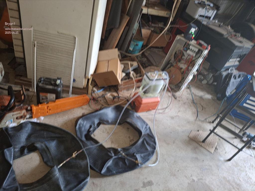

Well just came up to the shed and found the power supply was in OCP ( open circuit protection) and both of the tubes do have good signs of filling
Now what I expect is the amps slowly got to the max set point which was set at 8.3 amps so the OCD protection came in.
Now in that picture the tube on the left one can a distinct fold which now filled out and that one is the positive side ( Hydrogen ) and the other tube is is also filled out.
Just checked the battery voltage and I'd say it would of run for most of the night too and I'll run it all day today where I can keep an eye on it.

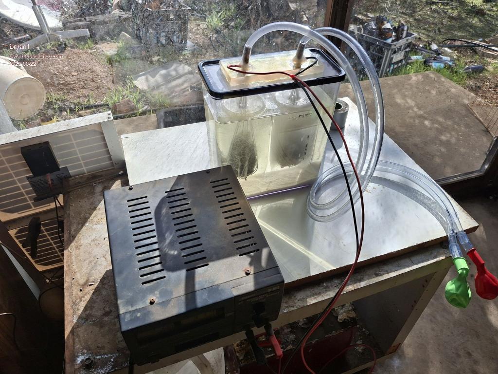

Well been running the unit all day and just noticed the current output had dropped to nothing
Man the unit was warm so left it for half an hour and topped up the water with nice cold water. Got back running on 10 volts with a 3.451 amp current draw.
Now silly me had my wires crossed and it's the negative rail that outputs hydrogen not the positive rail. Now as we are making 2 hydrogen atoms to one oxygen atom the way the tubes were filling gave me the tip so checked it on google.
Anyway below is the output so far
So as we can see the tube on the right is the hydrogen and it is not far away from being filled   I do have some E sized oxy/acetylene bottles to use as the storage and sorted the fridge pump for the hookup, also had a copper outlet for the acetylene bottle which will make for easy filling.
Cheers Bryan

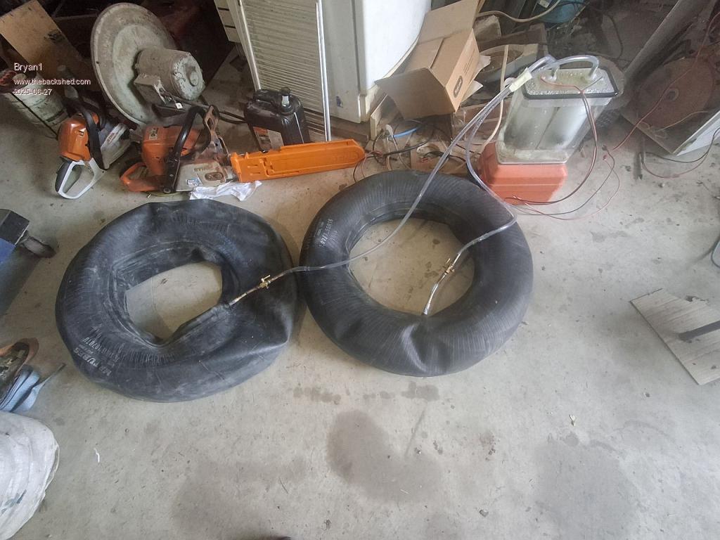

Morning Guy's, Well leaving the power supply on 10 volts worked over night and got a heap more filling done
Now just did a bubble test and rather than a loud pop the bubbles just burnt very quickly
I'm going to keep filling until like with the balloon run where the water level drops in the soda bottle showing it has reached the max pressure.
I have ramped it up to 15 volts with a 3.231 current draw and keep an eye on it today and I do think by this afternoon it may be ready for decanting.

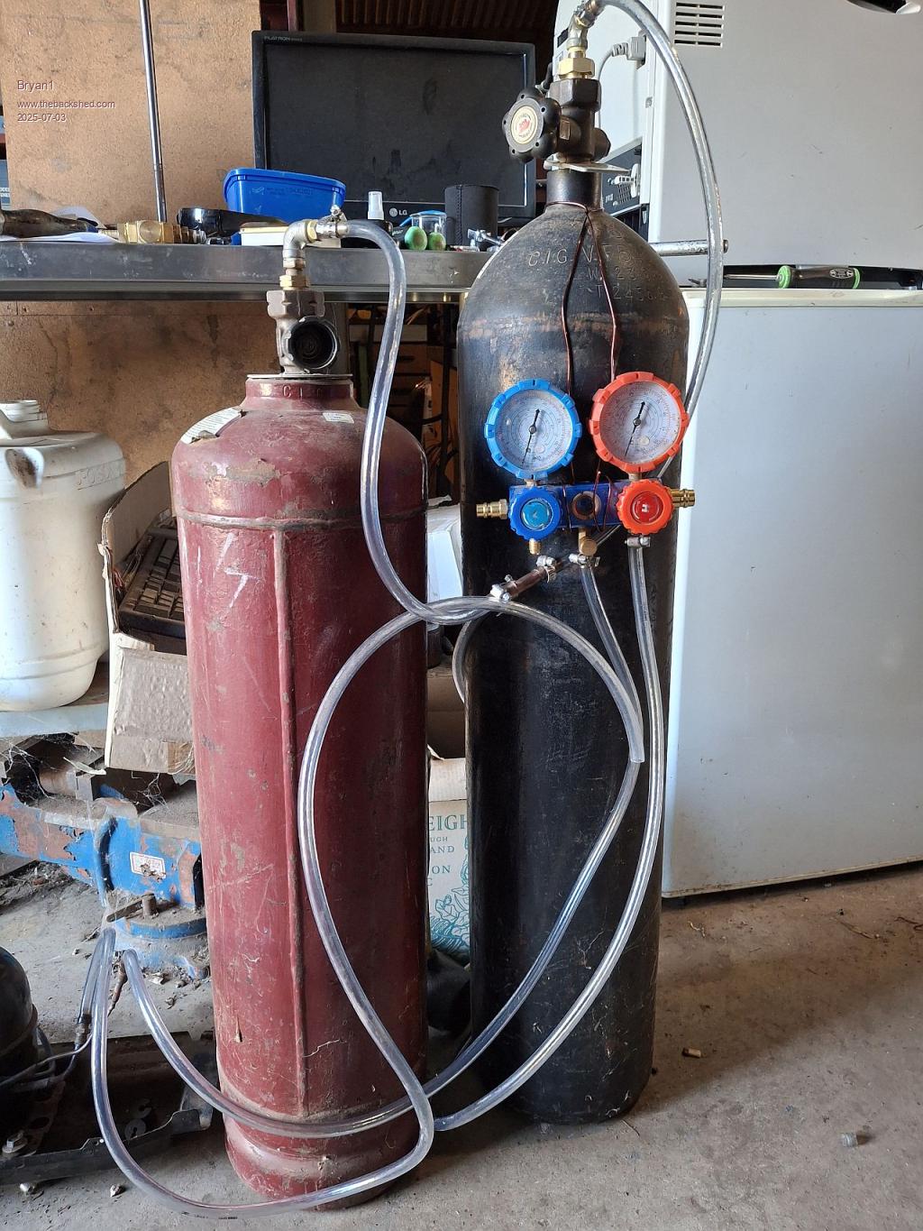

G'Day Guy's,

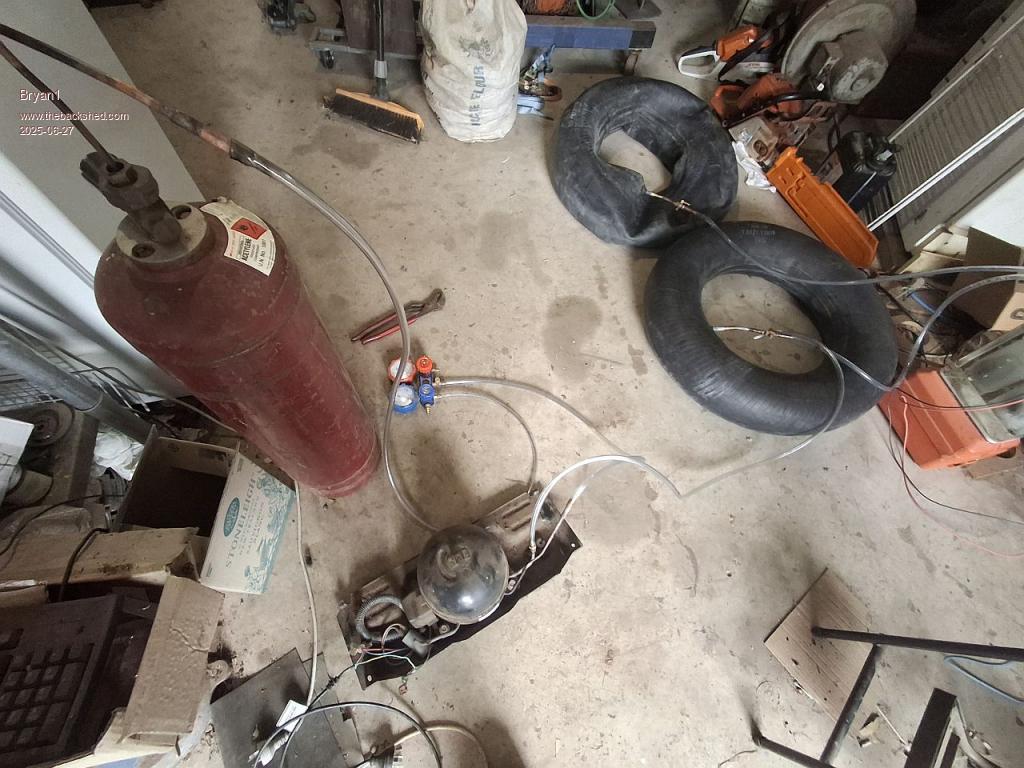

           Well decided to do the first decant just now and off the first batch got 20 PSI in the tank
Here is a pic of my decanting setup
First I pulled a vacuum on the tank using the fridge pump and used that cheapo gauge setup I got off ebay where found it only half finished. Anyway just using the ports I've found it's good for pulling vacuums and like today able to read the pressure attained.
I found the beauty of that clear plastic 8mm tube just a quick heat with a lighter then push it onto the 5/16" copper tube. Now I did find when I closed the valve on the tank the hose shot off as the fridge compressor was still going
Anyway I'm pretty happy it's only taken 2 days to do a cycle   also as the other tube is much larger I have left it and will decanter off the second run or sooner if needed.
Still a long way to go now it is looking good where for a few dollars one can make their own setup and best of all being off the grid the cost of power is zilch nada nothing
Regards Bryan
