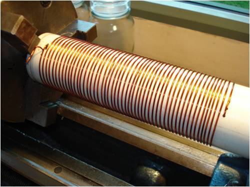

had ago at winding a radio coil.

Nice job Bruce. Whats it for, a crystal set?

Hi Bruce,
You may ge able to wind the wire more accurately by first cutting a thread slot into the former first. I am not sure if your lathe has thread cutting facilities.
Gordon.
Posted: 10:13pm 23 Mar 2010
I used to feed a length of string beside the wire, to give a even spacing. Then unwind the string once the wire was secured. A little varnish will hold it all in place.
