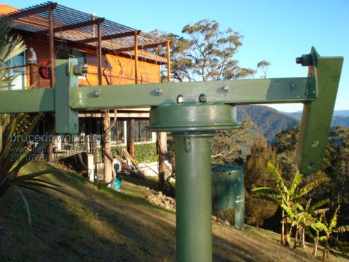

I'm playing again....

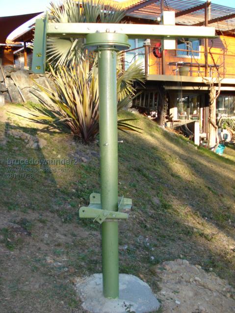

Just welding ,grinding,painting and generally keeping busy . I hope it all comes out OK .

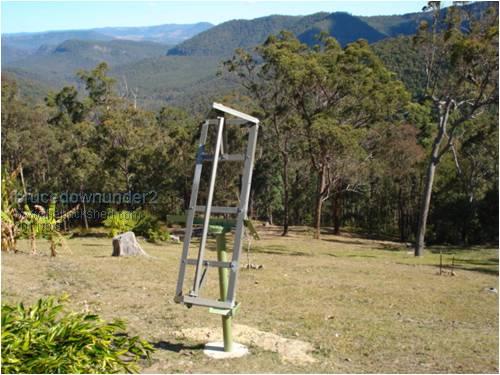

Iused to get shading with my old elevation/rotating frame ,so decided to give the u-beaut "follow-the-sun" type a go ..

Hi Bruce,
Interesting design you got there. You may remember my two axis tracker I posted about here a couple of years ago. Its still going strong but, like everything I build , there is room for improvement.
So my MkII version is well underway now and I'll post pictures when its working. It looks nothing like my MkI or yours, BTW

Yes, A couple have noticed the lack of side bracing.. I've allways intended to add these, just that I've got to get a "aroundtoit" ...
took the trailer down the hill yesterday and got some concrete blend ,so we're in business again..
I'll have to weld up a split 4inch pipe piece with side clamping flanges .
The ground is fairly rocky , so thats in my favor also.
My windgennie anchors are "deadman" style and backfilled with concrete/rock . They ain't goin anywhere fast.

On the question of mounting the pole in the 'rock'. My structural engineer made be embed the pole 600mm into a 600mm diameter hole 2.2 M deep - but in soil.
The 'lift' from a strong wind is very large and his main concern was 'friction' between the mounting and the soil. (Maybe, you could make your rock hole 'bell shaped' at the bottom? Just a thought.)
Aren't car wheel hubs great - no (or very little) machining.Edited by neil0mac 2011-07-30

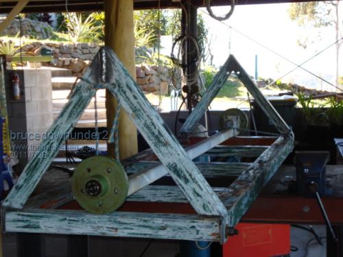

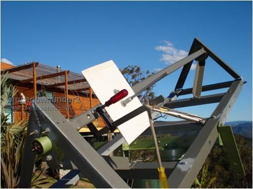

Got around to fitting a bit more steel together - the axle is mounted ready for the solar panels . Then the job of fitting some actuators and cabling ..
Close up of the 3.30pm angle ,,turning out OK , so far ..

,, It's very strong and if I get the anchoring right ,then it would take 4 800x1600 panels (175 watters) easy. Six , I think would be pushing it a bit ,,we have had 120Kph wind gusts up through the valley to where this contraption is built.
I have no problems with the engineering ,just the "up-lift" is worrying me.

It is a simple matter to increase your anchoring with a retro-fit base. Box up a square metre or so (and 100 mm deep?) around your pole and sink 4 holes (300mm? dia) at each corner as deep as you deem necessary. A bit of concrete and some stiff reo and the wind will have to lift your entire back yard (well, almost!)
For some added security (and/or to save concrete mixing/pouring) angle the piers out at say 30 deg for less reliance on 'friction' at the sides of the holes.

I'm going to do what you said but probably just steel posts in concrete being bolted to the maim pipe.. I have to consider the easiest way because just getting concrete down there is a bucket at a time job.

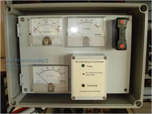

Have sort of nearly finished the input "look and switch" control panel ..The 48v regulator was designed by Ross W and built by Bryan .Thanks .

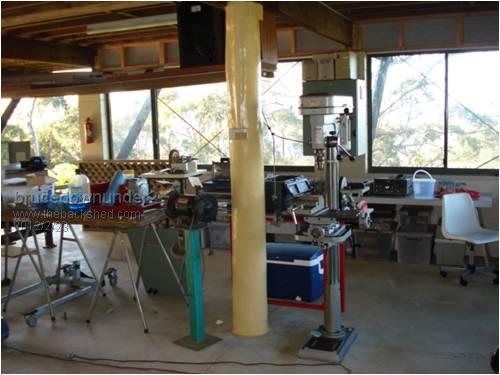

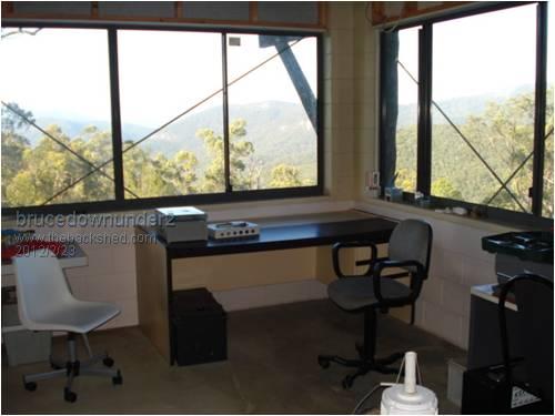

Hi Allan ,,
Yes have done a bit ,mostly the concreting and two sides are window and door .
Still to come , gyproc ceilings , stud and cement sheeting back walls .
Presently , setting up the solar tracker /Panel control gear and the Exmork 3Kw windgennie control gear and Battery Banks (48v)
Having fun in the playpen...

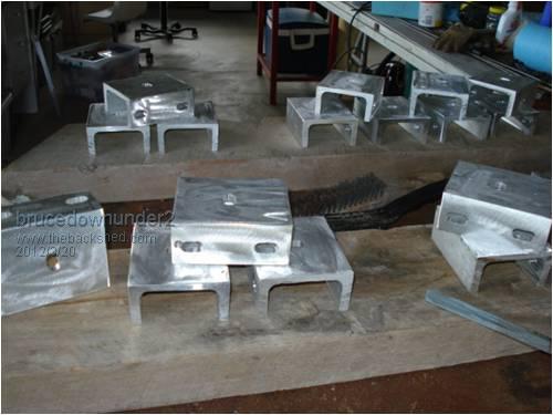

Cut up some AL channel I had laying around for the last 15 years into 100mm lengths for support pads for the panels .. I decided to mill the 8mm holes out so I would not have to remove them if the holes are slightly out ..
there are 4 panels of 220 watts ,so I had to fabricate 16 of these brackets ..
next is the etch primer and then epoxy painting --want all the structure well painted and no maintanance for many years.

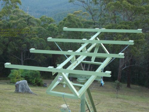

Posted: 11:15pm 21 Jun 2012
Hi Crew ,,
just did a bit more towards the solar panel mounting on the frame --I'm slow at these things , have a hundred jobs being done around here between bouts of very painful gout ... 67 you wait --- don't laugh!!.
OK, painted the Al mounting feet to go no the steel rotating frame -milled out the mounting holes for some "play" in bolting them on . (Bit hard mucking around up there on step ladders with a 3/8 inch drill into 1/4 thick steel)
fitted them after drilling all the required holes in the frame steel ,,in the workshop with my press drill,,.
3 coats of paint and I'm out in the paddock again ready for helpers to man-handle the solar panels into position on rubber insulating washers and stainless steel bolts.

Posted: 03:01am 22 Jun 2012
Yeah you cant rush these things Bruce
One thing, is there any change the panels will be flexed? I once had a panel that was mounted on a frame that bent in the wind, twisting the panel, and ended up cracking a lot of the cells.

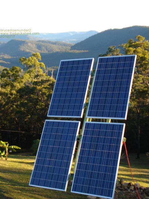

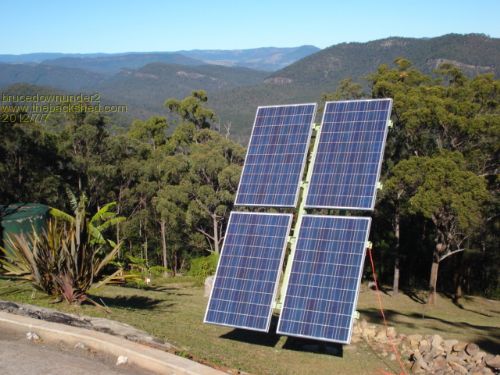

Posted: 12:04pm 07 Jul 2012
Hi Crew,,
Well, finally got the panels mounted with some help from neighbours,the fixing bolts and nuts were difficult to fit-my mistake in the preparation of the mounting blocks.
It's very rigid , and yes Glenn, I will be fixing side braces . There is 900 watts swinging around there , I don't reckon any more panels would be wise..

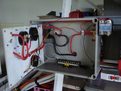

Working on the inside control bits and pieces now, have to be carefull,50 odd Vdc is a bit dangerous.I just don't turn the breaker off , I disconnect the supply in lead.
Now for the actuators and additional post to support them -more concrete and digging ,will it ever stop..
