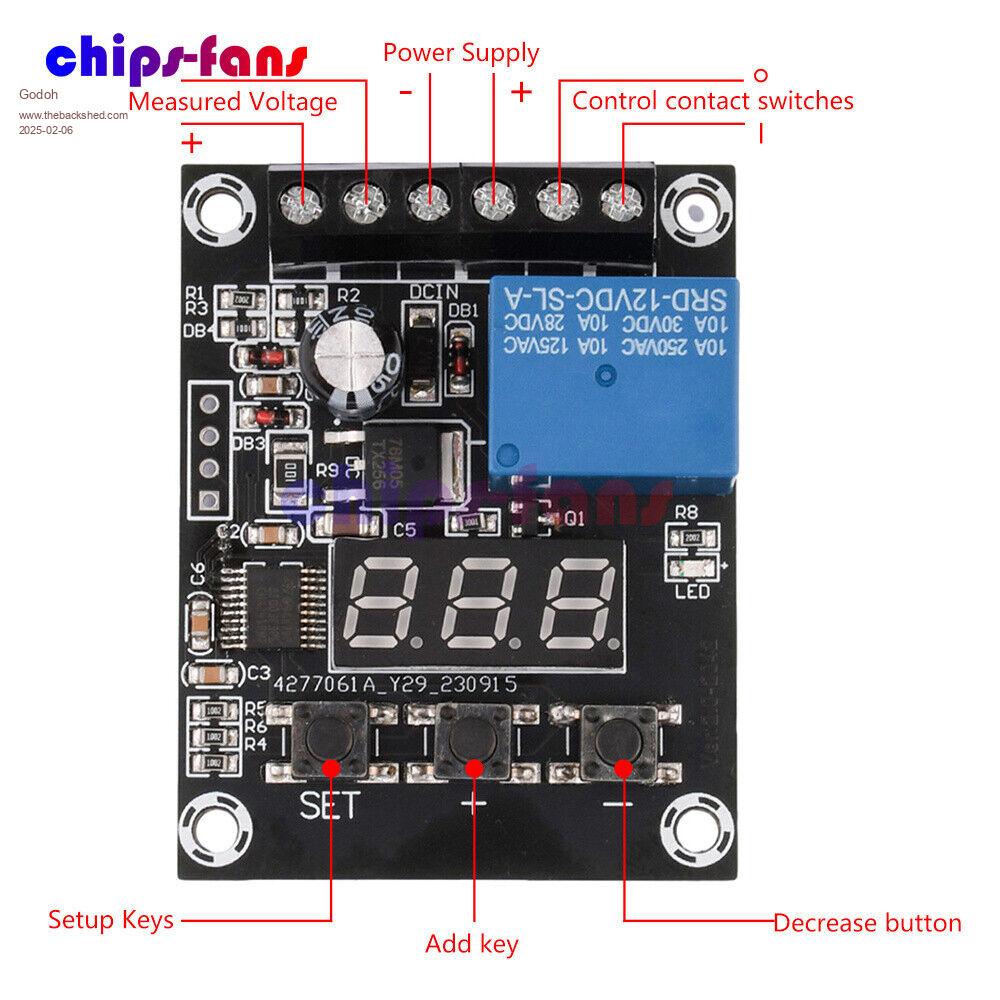

Hi Bryan, here is a photo of the board connections on mine.
Bryan1
Joined: 22/02/2006
Posts: 2298
Posted: 10:34pm 05 Feb 2025
Thanks for that pic Pete and it does clear things up now as the relay is a 12 volt one does that mean the power supply is 12 volts ?
Regards Bryan

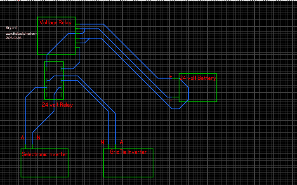

Well went down to town and got that panel mount relay this morning and typical win10 doesn't have the original paint program so I just did it in Sprint Layout and used paint 3D to sort the picture.
Now assuming the power supply is tied to the 24 volt battery and I reckon I have the panel mount relay correct. There isn't much into it really is there, just a couple of sense wires and a panel mount relay.
Regards Bryan

Hi Bryan, you may find that the way your diagram is showing the connections that there is no voltage at the relay coil that connects the GTI inverters.
You probably have to pick up a negative to go to the 24 volt relay coil, and put a jumper in from the power supply terminal on the voltage controlled relay so that the voltage controlled relay contacts switch the positive to the 24 volt relay.
Pete

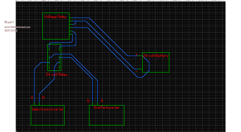

Posted: 06:18am 06 Feb 2025
So like this Pete
I did have the relay coil the wrong way around and doing this mod should give the relay the battery voltage to switch on.
Now my understanding with the Selectronic AC connected to the centre pin of the DPDT relay and the grid tie on NC pin when the relay energizes the grid tie is taken out of circuit.
