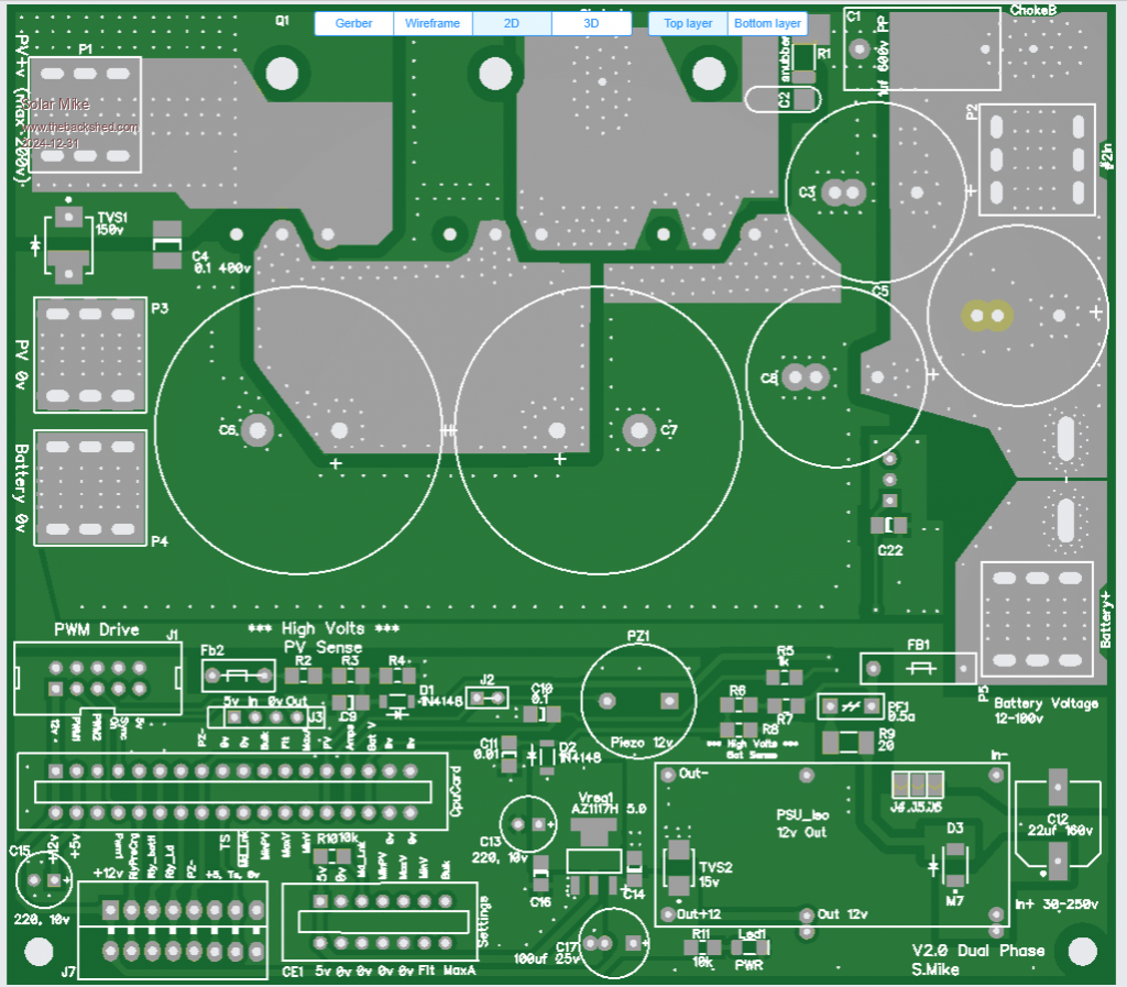

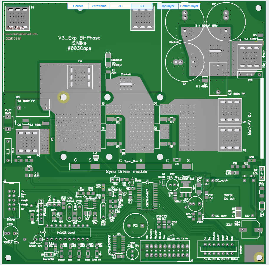

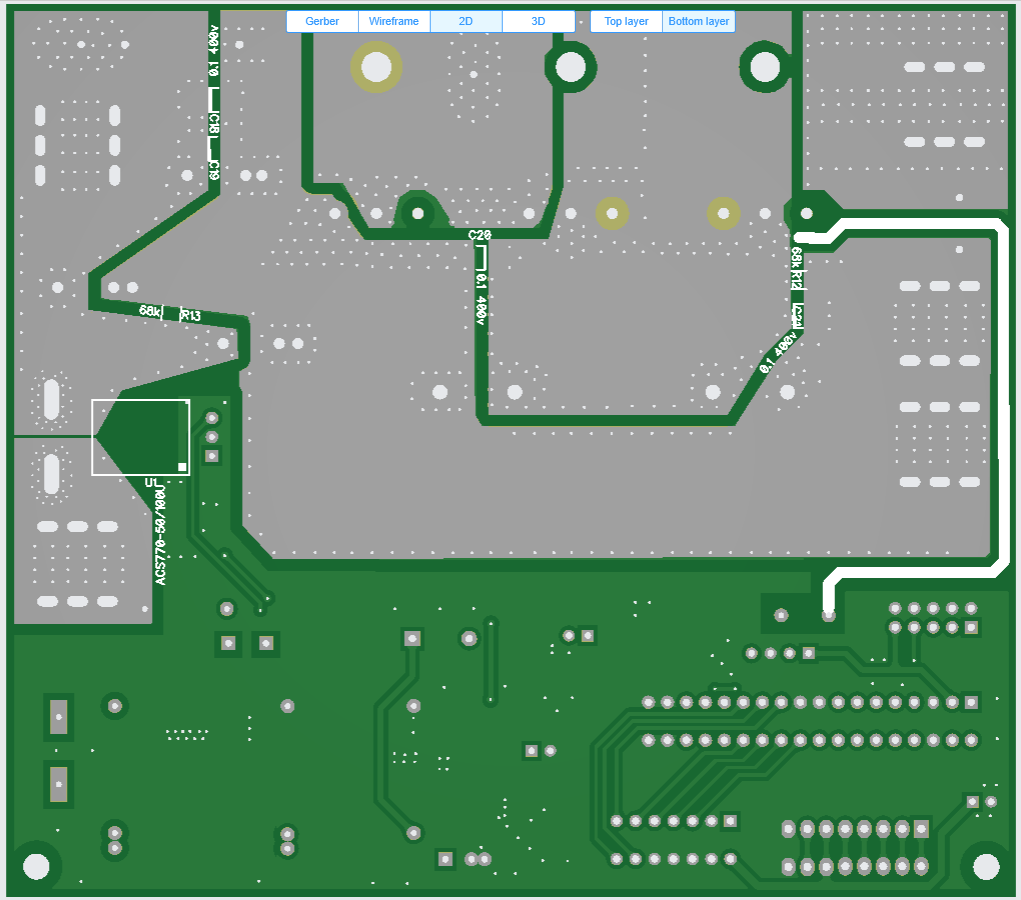

Here are some of the PCB designs: 150 x 150mm
The main mosfets are TO-247 200v types (DWX9R820H from LCSC) bolted under the pcb to the alloy case, I originally had 150v rated ones and occasionally one would self destruct when running off a 120v DC supply, caused by a 100Mhz 20V ringing spike, a 2200pf cap and series 6R resistor snubber across the L0 synchronous mosfet cured that issue.

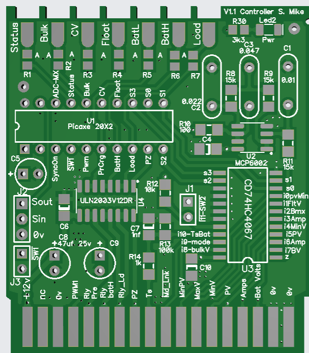

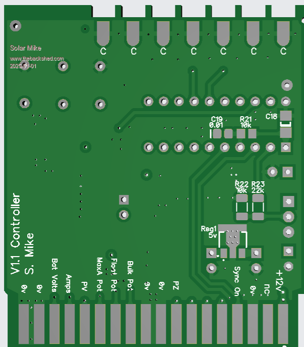

CPU is a Picaxe 20X2 on a small 4 layer pcb that plugs into an edge card socket, the other edge card socket has the setting up pots on a small pcb, when unplugged their values are stored in the cpu's eeprom memory.

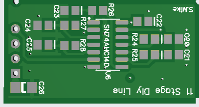

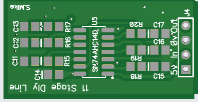

A small pcb module has an 11 stage RC digital delay line for generating the 180 degree other PWM drive phase, the ribbon cable going to the mosfet driver pcb can be extended to another main board power stage (no cpu or associated bits) to increase the power handling if required.
Charge state leds are soldered along the top, an analog mux is used to sample data inputs, its output via an active filter to the cpu's ADC input.
CPU Card (4 layer)

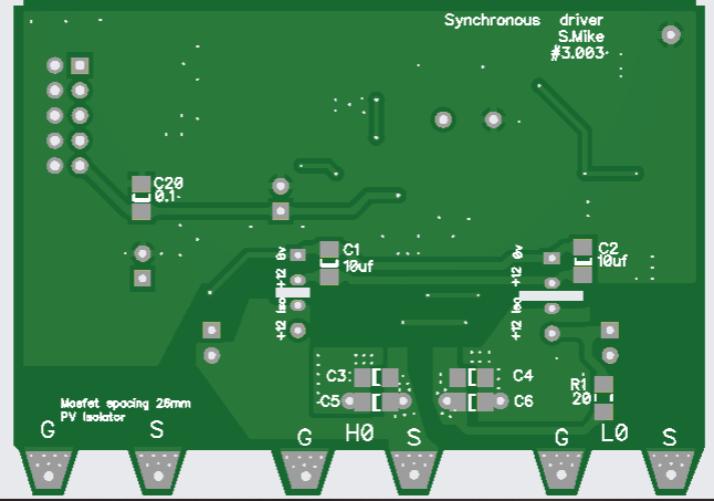

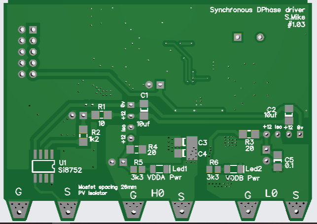

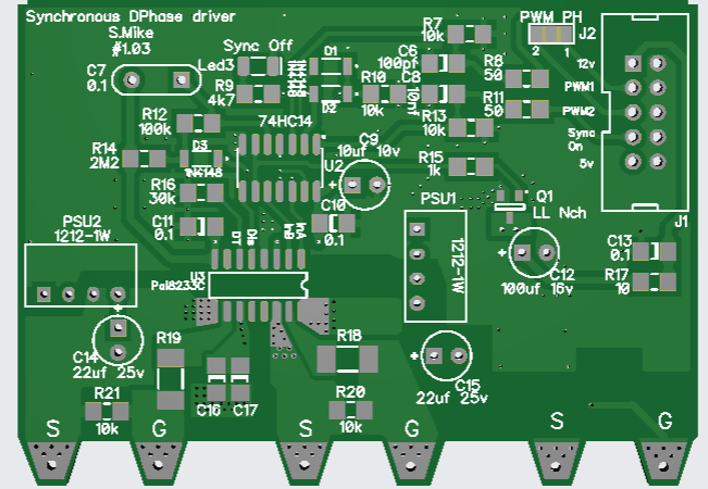

The mosfet driver pcb sits directly on top of the main mosfet pins, using some logic gates and a Pai8233C-S1R isolated half bridge driver chip; this keeps all current drive loops short and allows for an easier pcb design of the main buck circuitry. When pwm drive is turned off, the driver chip and the 2 psu's are shut down to save power.
Driver Card:
Phase generator Card:

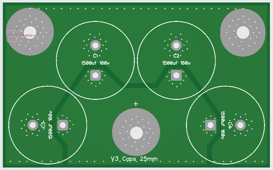

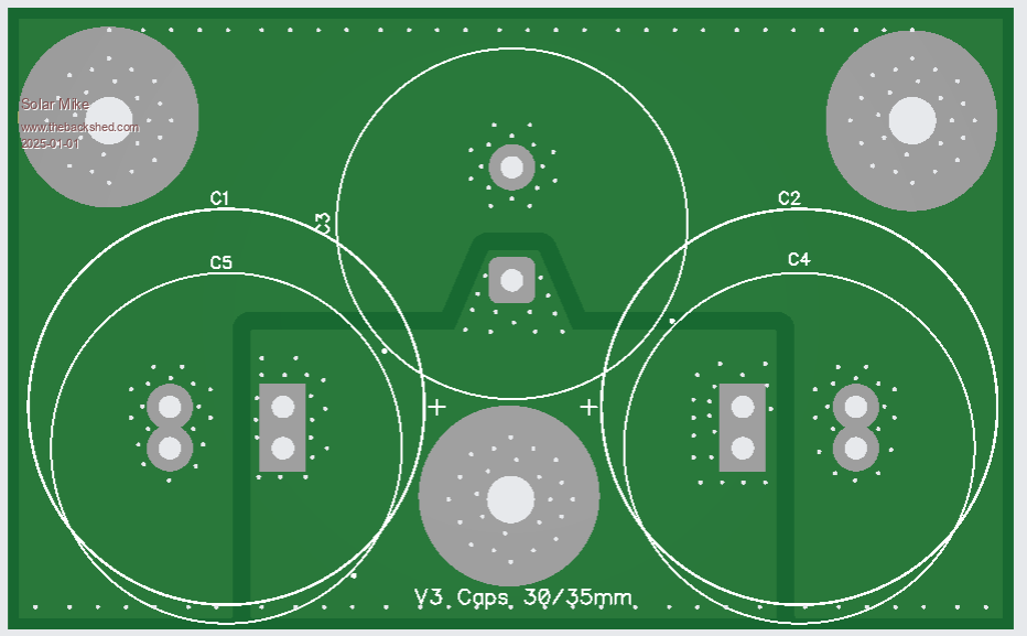

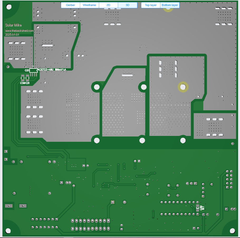

Along with the above design using TO-247 mosfets, thought it would be fun to use practically the same circuitry with surface mounted TO-263 mosfets (DWY9R820H LCSC), they mount on the main pcb same size 150x150mm and are thermally connected to the alloy case via a 5mm aluminum spacer block and isolating fabric pad. The same mosfet driver card is used, main caps are mounted on a small pcb, so I can use different types easily.
With more room on the pcb, have placed the cpu on the main board rather than the edge mounted card
Main PCB, 150x150mm:
Caps PCB's:
Both pcbs are same size, must have scaled differently when taking snapshot.
Next item to do is get the 2 phase part working, the latest pcb's have just arrived, so out with the soldering iron. Once I have something running 100% will draw up a schematic, at the moment its all in my head.

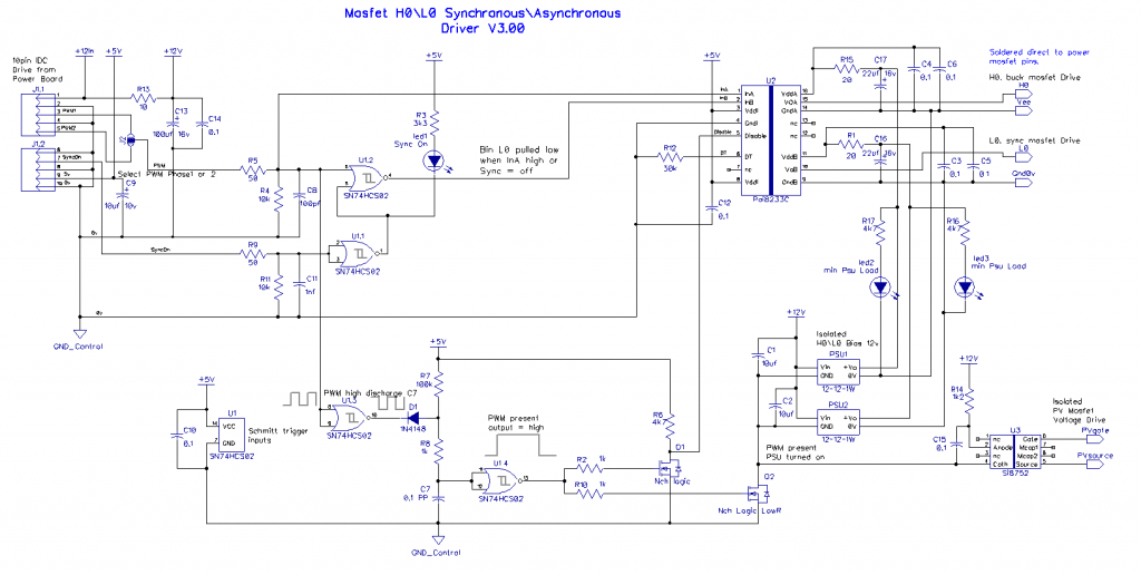

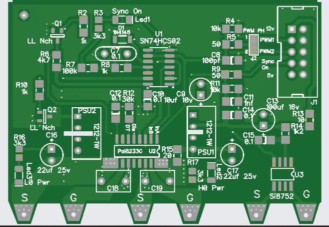

I have altered the driver card somewhat, in removing the gate drive resistors as these are now on the main power board, and simplified the circuit by using a quad nor gate with schmitt trigger inputs. Both the Pai8233C mosfet driver and the Nor gate SN74HCS02 are very cheap at LCSC.
The synchronous mosfet driver will automatically switch to asynchronous mode when the input sync signal goes to logic 0, this happens on low charge currents < 1 amp and prevents the synchronous mosfet circuit acting as a boost converter with possible smoke release on very low duty cycles.
When PWM signals are present the pulse extender turns on the power to the 2 small 12v isolated bias supplies and the PV isolation mosfet drive.
The IDC input cable input has 2 PWM drive phases present, a solder blob jumper selects one to use, the IDC can extend to another power board\drive card, without any cpu or other components; this will drive the buck circuit 180 degrees from the first, using a common PV input to both power boards.
Have drawn up the driver schematic to make sure the new PCB has no errors.
Will send the new board away shortly.
PCB, 70 x 50mm:
