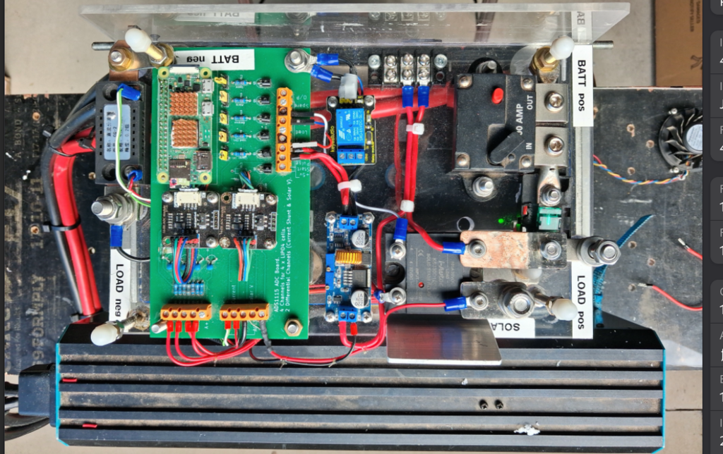

I installed a 10A Transformer Active balancer.
Control:
Using 2 x ADS1115 boards that equates to 4 Cell Voltages, 1 Differential Solar V
and 1 differential Current shunt V. I do not measure Cell Temperature.
As my Solar is below 40A, I am using 1 x 60A SSR that is pwm .
The software chases MPPT and controls the charging current.
All of this happen on a Rpi Zero 2W with a 10" lcd.
A cpu cooling fan is relay controlled to switch on above 60 C.
No RTC is fitted. The critical info is transmitted to the Cab via Wifi hotspot
onto my GPS screen.
Planning a Camping trip in the next few weeks, so that will be the final test.

The Rpi drives BC107 transistors that drive:
1: JayCar 60A SSR with 5vdc pwm.(Chinese brands failed on Current capacity)
I put a homemade L channel heatsink under the SSR.It hasn't got warm yet.
2: Small CPU Fan Relay with 12vdc which only comes on when it is hot as all of this
is deep inside the Ute with a Canopy on top and other camping stuff blocking air flow.
On the pic you can just see it removed but on the left.
3: Blue Xeon Alarm Light so I can be alerted when driving that something has gone wrong.
Happened once with my LiPo4 Cells when I left the Inverter on to long.
4: Each O/P is connected back to an I/P and is used to confirm the status of each O/P.
I2C:
2 x ADS1115 a2d converters on i2c.Precision resistor dividers, however I calibrate
the conversion to an accuracy of about 3mV for the Cells. SolarV is less demanding
and it has an accuracy of about 40mV. Current shunt is good for 34mA
All of these are of course calibrated with charging Off. I actually bought a Voltage standard
to confirm which of my Multimeters was accurate.
It is worth noting that I have had a number of board failures when using the miniature
version of this board, but the larger board (Gravity) has had none.
On each channel you need to throw away the first 10 readings to allow settling
and prevent cross contamination from other channels. The channels are multiplexed.
When you then graph the .csv files in Excel the values are remarke-ably stable.
The counts sit within 1 count and slowly goes down over many minutes as the Rpi etc consumes power.
1 x 12v to 5vdc converter, it has a switch in the Canopy for easy night time shutdown.
1 x Modified shunt. I only measure Solar Current as total load of lights and Fridge are known.
The Inverter bypasses the shunt as it sometimes takes 180A.
Simply cutting bars out of a 250A Shunt made it a 50A accurate shunt.

Unable to load Picture of Board mounted on the Cells.
Converted .png to 50% size
Printed to .pdf
Tried .zip
None will work.

Hi All
Thanks Revlac for the suggestion.
Converting a png to pdf makes the image almost unreadable.
However, zipping the png file worked well, so hopefully you can download it and unzip it.
The 6mm clear Acrylic lid with fan is removed for the photo, but is just visible on the right.
The Renogy 2000 Watt Inverter at the lower end of the photo.
The visible green light is the balancer mounted directly on the cells.
The whole thing is secured onto Concreters Ply, that slides into the ute out of the way. Inside my Canopy I have a small lid that opens to the ute base and gives me access to the Isolator and Inverter switch if I need it.
Board1png.zip
Hervey Bay Qld.
Revlac
Joined: 31/12/2016
Posts: 1310
Posted: 09:17am 11 May 2026
That's nice neat looking setup.
Ok uploaded.
The bootlace ferrules work well in those terminal blocks.
Edited 2026-05-11 19:23 by Revlac
Cheers Aaron
Off The Grid
Dinosaur
Joined: 12/08/2011
Posts: 360
Posted: 09:39am 11 May 2026
Hi All
I was reluctant to use those ferrules for many years as I saw wires easily pulled out.
However once I learned NOT to use them on solid core wire AND pick the right size ferrules, it swayed me.
They are also so much easier to push into the kind of terminals that have a clip
keeping the hole closed until you push something solid into them.
Did you notice how I used the lugs into the Isolator ?
Also the 40A fuse just to the right of the green led.
The hardest thing to get in Hervey Bay were the Nylon Dome nuts that keep the lid on.
Didn't want something metallic accidentally sliding across it and shorting terminals out.
Hervey Bay Qld.

I had to look up that style of breaker in the photo, yes you did well there, good use of terminals.
Yes the nylon dome nuts are a good addition it reminds me I should do something like that to some parts on my battery system, especially the main battery isolator I have...a little bit of 3D printing will fix that one day.
