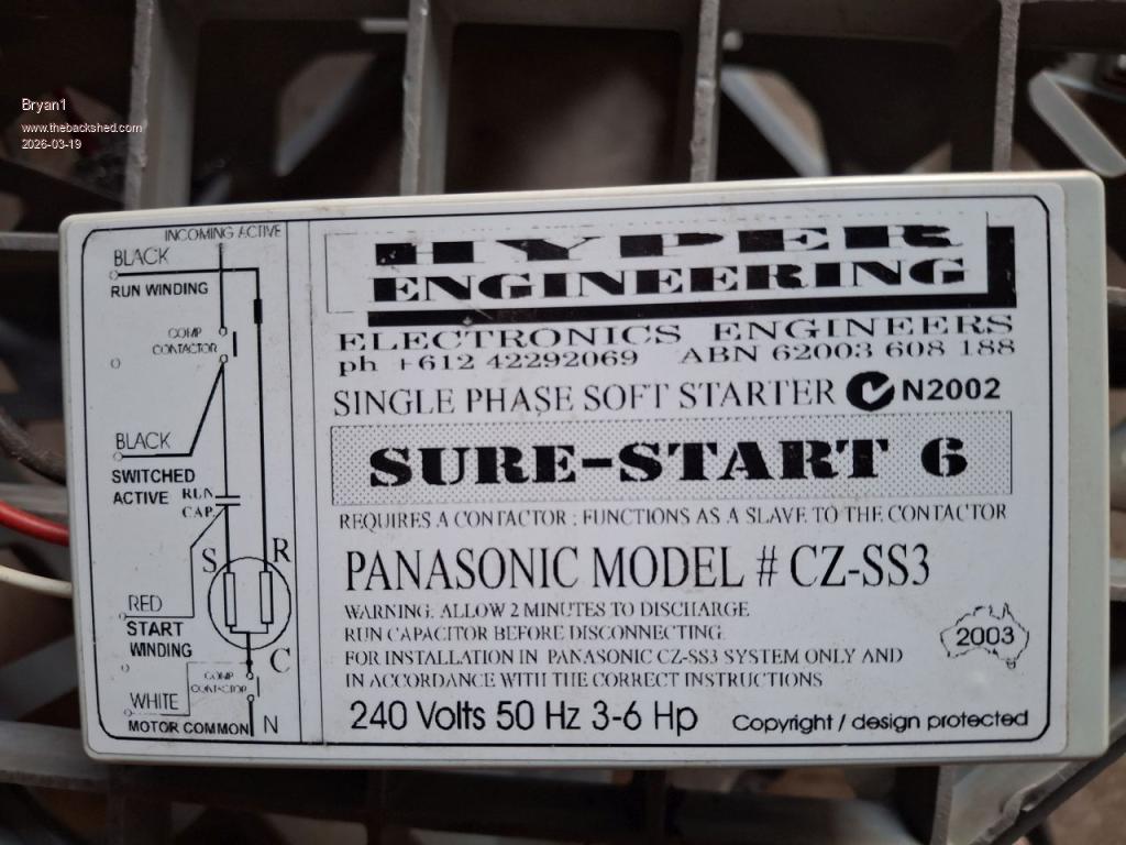

G'Day Pete I do have a couple of soft starters here and below is a picture of one
Regards Bryan

Thanks phil, I will have a look at the motor tomorrow. I think it only has one capacitor, so it must stay in circuit all the time.
Sounds like a good plan to put the starter only in with the run winding.
Bryan have you tried using one of those starters you have?
That looks like it is for an air conditioner.
I can't quite figure out what they are doing with that starter, but it looks like they are switching the start winding out of circuit after it starts.
Doesn't quite make sense to call the capacitor the run capacitor in that case.
